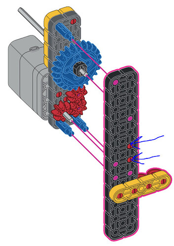

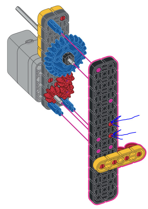

Hi Jessica. Do you have these two red pins in place?
These pins don’t clip to the red gear, but when assembled they are inside the concave section of the gear which stops them popping off.
Thanks @Chris_Calver ! Students do have those in place, but definitely a good detail to double check on their builds.

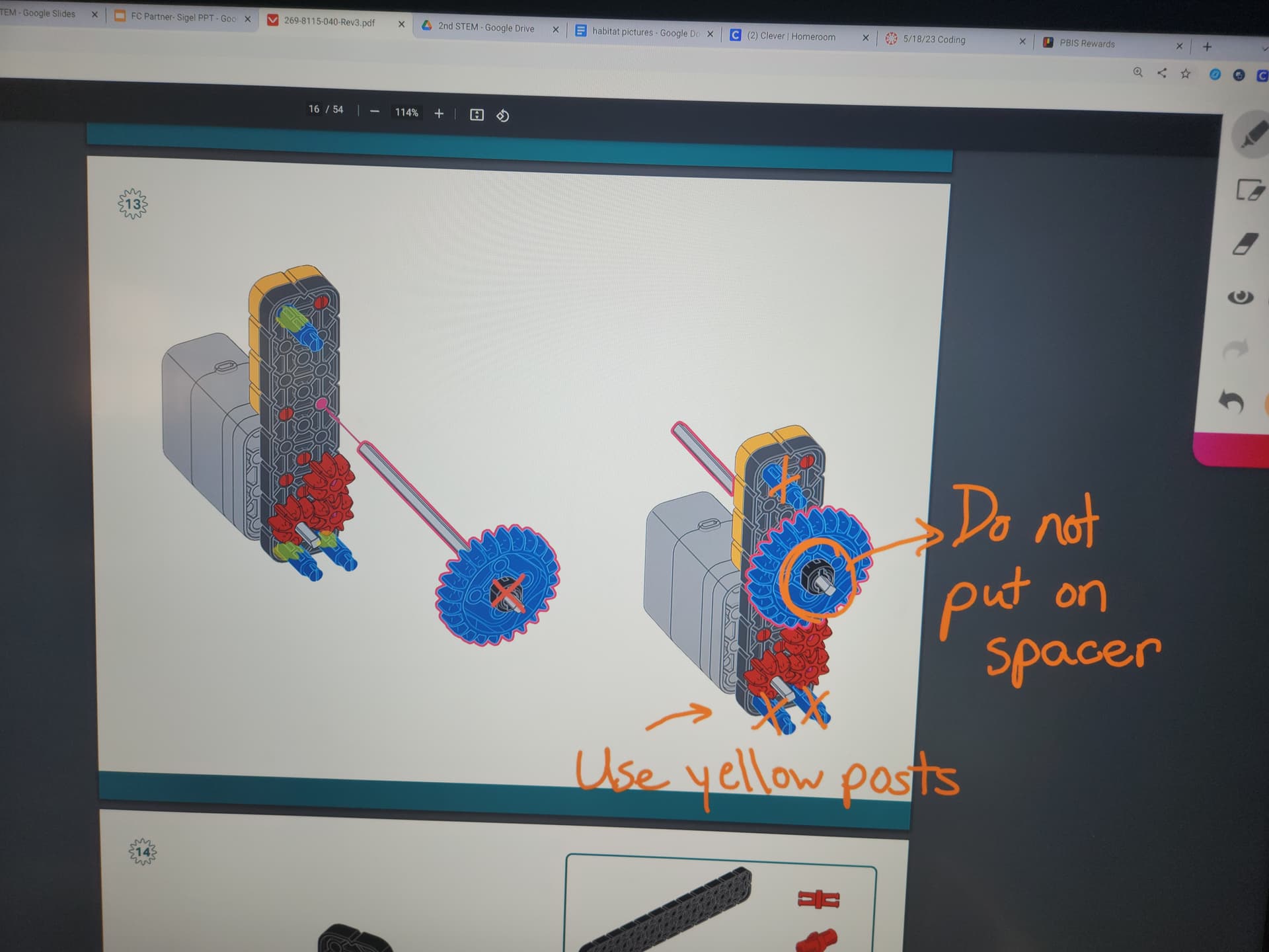

What is so awesome… my students figured out a modification that has been working really well!!
The black spacer is taken out, and then yellow standoffs instead of blue.
