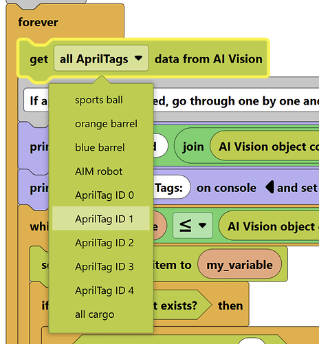

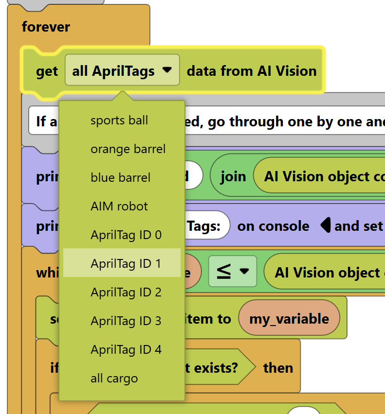

1. “All AprilTags” option missing from the dropdown
I just verified this on multiple platforms and devices, and the “all AprilTags” option is currently available everywhere.
It may have appeared missing because the dropdown contains many options, and “all AprilTags” is located at the very bottom so you need to scroll down to see it. That could also explain why it was difficult to find.
We’ve taken note of this and will look into improving the dropdown usability in the future.

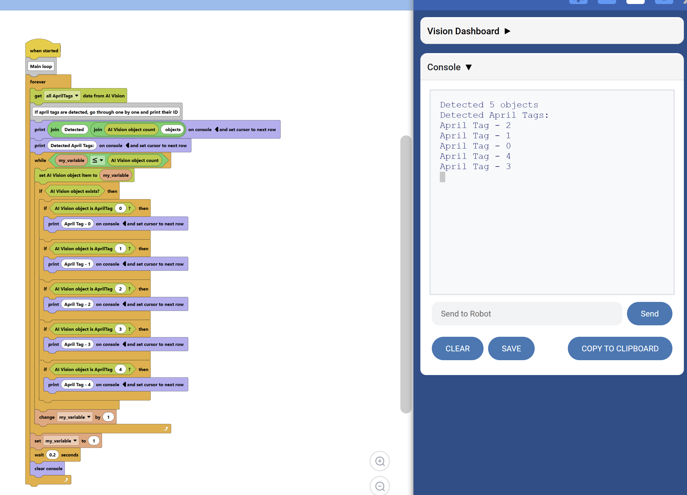

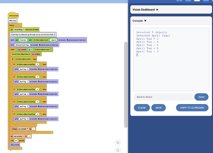

2. Student code ignoring April Tags 1–5
You mentioned the robot firmware is up to date. We ran several tests on our end and were not able to reproduce the issue.
This may be related to the project logic rather than the VEXcode or the AIM itself. To help isolate the issue, I’ve attached a simple test project we used. This project prints all detected April Tags to the console.
You can access the project here:
Show detected april tags.aimblocks (7.9 KB)
Please try running this project and see if it behaves as expected on your end. If you have any questions about the code or continue to see unexpected behavior, feel free to let us know.
