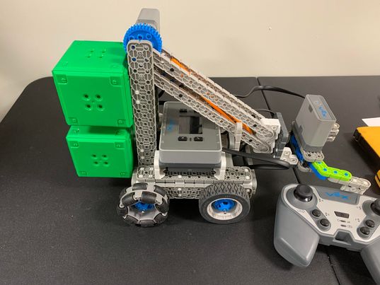

The clawbot seems extremely unstable. I will admit we jumped ahead to the clawbot to do a demo at our 8th grade basketball night. So we built 2 clawbots. Whenever we pick up a block or turn too fast or stop too soon (our velocity is at 50%), the thing wants to tip over. We added two cubes to the back of the unit (see the picture attached) as a fix. Is this an issue that we just have to be creative in fixing or is there a known fix?
I’ve been through most of the Facilitation Guides (skimmed them, to be honest) that dealt with the clawbots and couldn’t see any pointers. Us creating our own unique fix is ok but I just wanted to make sure.

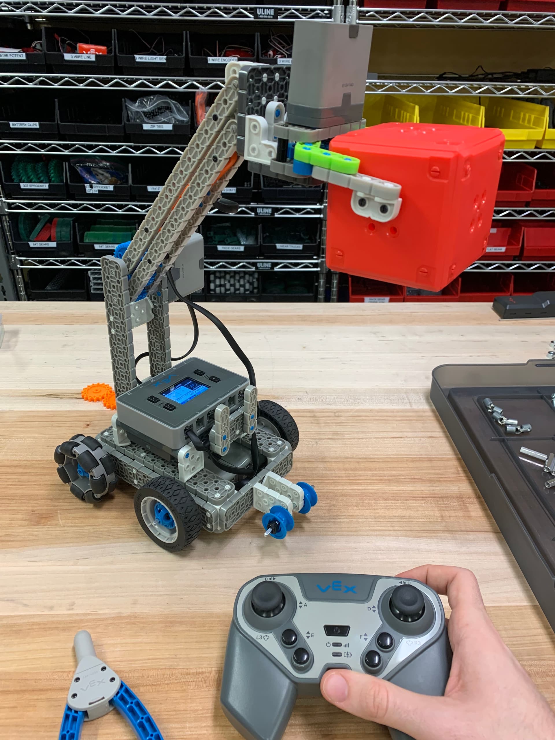

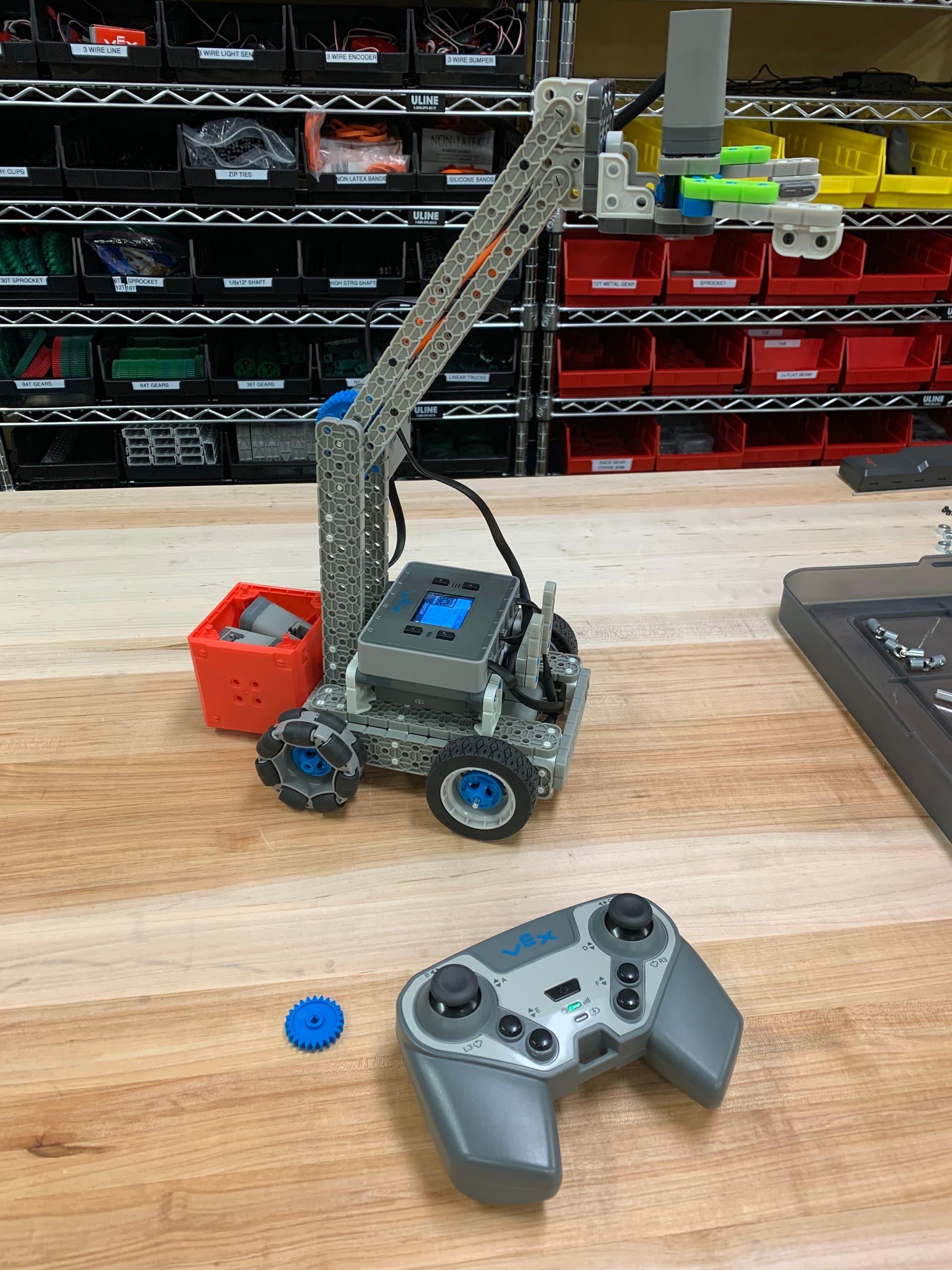

Check out some of the simple modifications we made, the first piggybacks off of your use of the IQ Cubes. I popped the top and added weight inside, this design is really cool as you can tweak how much you want your robot to be counterbalanced during play.
Next, we added another axle to the front of the robot in addition to makeshift wheels, to prevent tipping when coming to a stop. The next modification I’d want to make is reinforcing the arm tower, to prevent sway when turning at height.
What other modifications do you think can be fashioned out of IQ pieces? If you’re looking to create something specific (more stable drivretrain, more stable arm) please let me know and I can work with you and CAD to create some more 3D build instructions!
