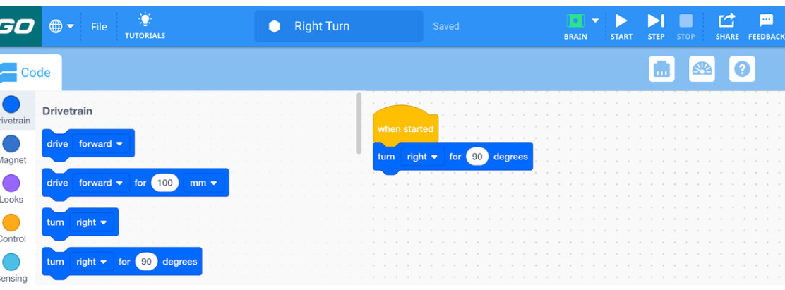

Could you please upload a screenshot of the program?
It just happens anytime I use a turn block, regardless of if I put a [drive forward for 100mm] in front or not
