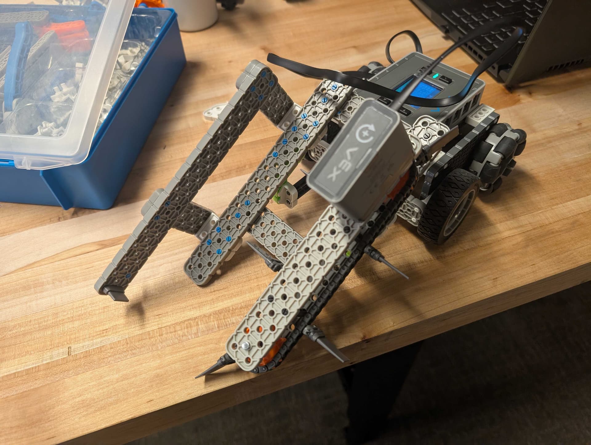

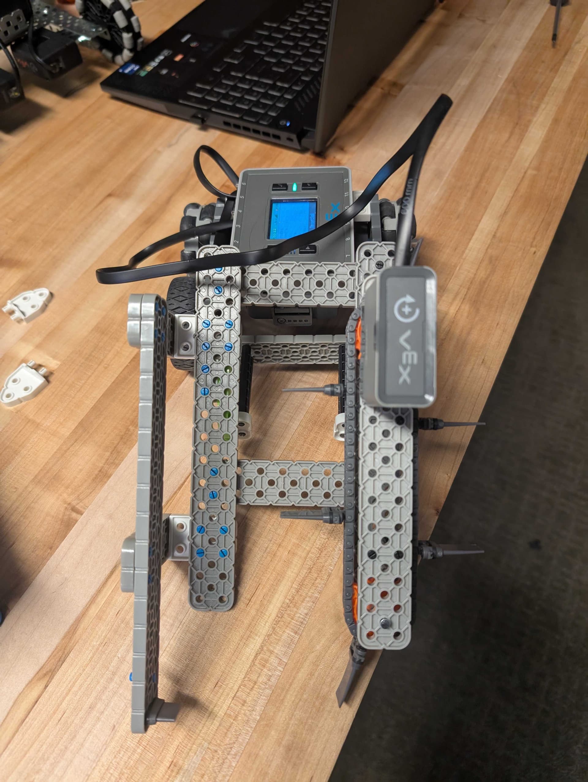

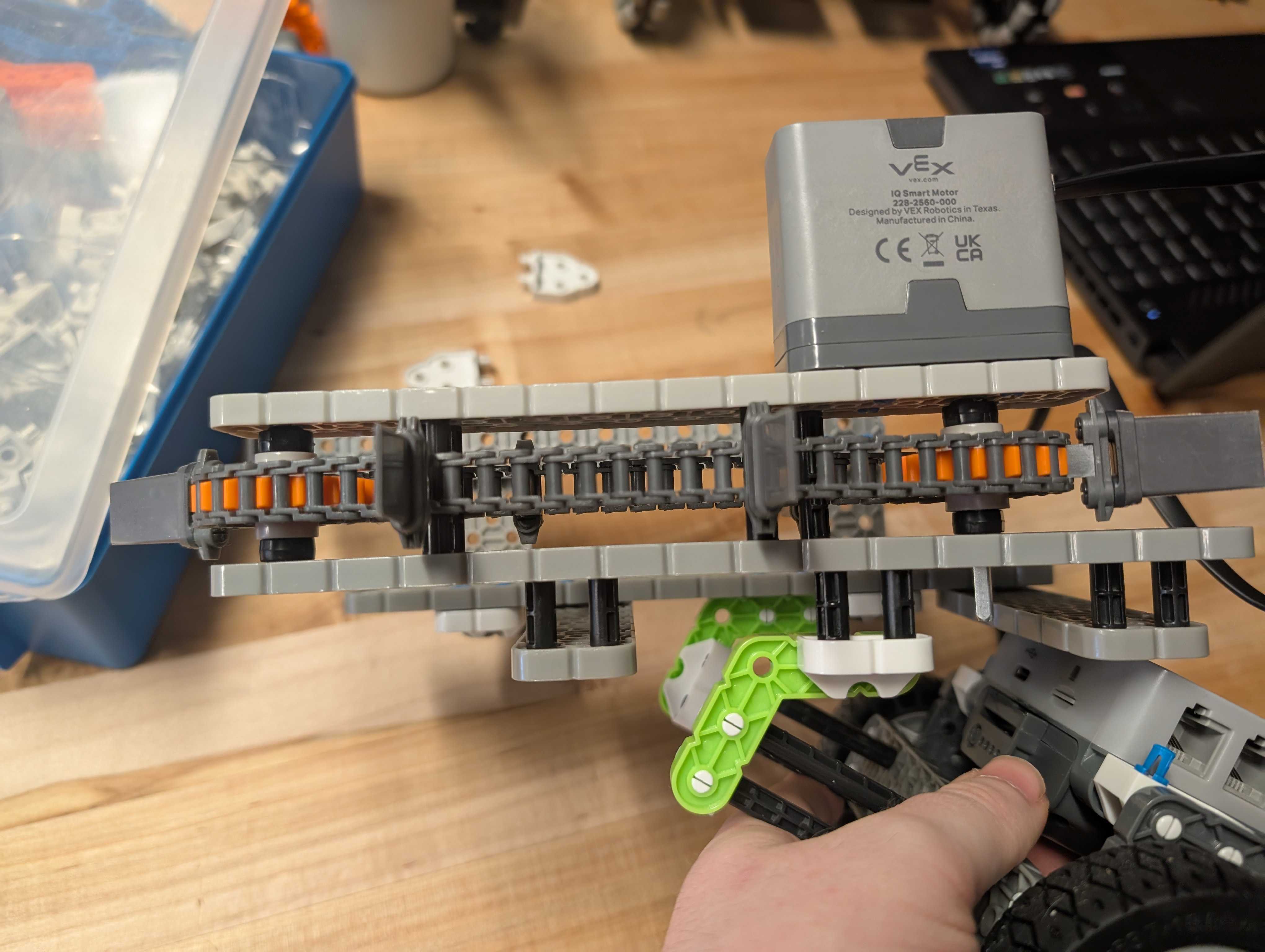

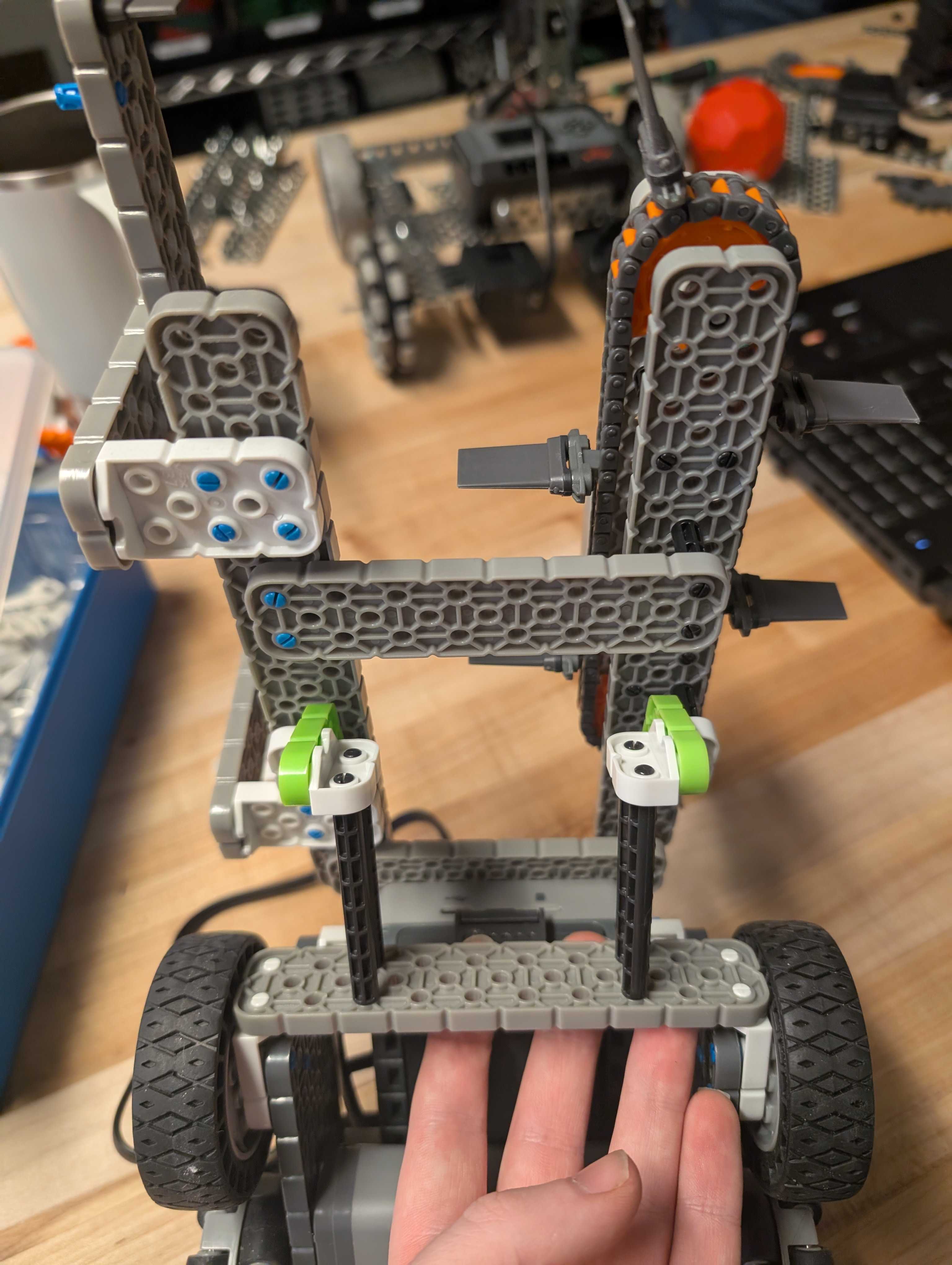

For inspiration for a toy grabber it would be possible to use the VEX GO Adaption claw as a base build considering the IQ Educational Kit has similar parts. As for the conveyor belt it would be relatively hard to do considering the educational Kit doesn’t have Tank Threads included, however if you did have some I’ve included a build down below that is efficient at picking up the IQ Cube that comes with the Classroom Bundle. I’ve included pictures and links to the referenced builds and parts down below, hope this helps.
Adaptation Claw:
Cadasio:Instructions Online by Cadasio.com
PDF:https://content.vexrobotics.com/vexgo/pdf/builds/simple_machines/Adaptation_Claw_Rev4.pdf
Tank Thread & Intake Kit:Tank Tread & Intake Kit - VEX Robotics
Conveyor Belt with Intake Flaps:
