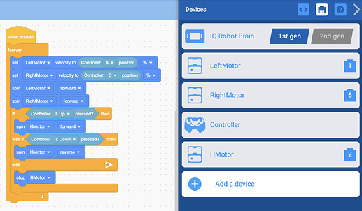

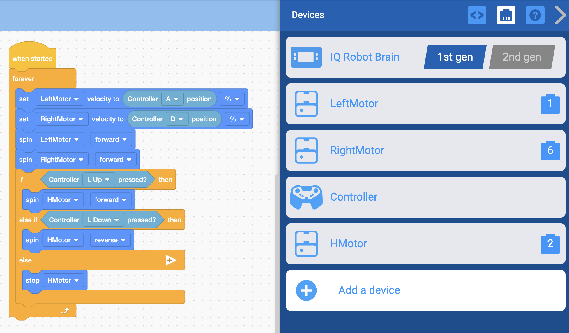

Here is a snippet of code for an H drive
You can see, I can set the velocity of two of my motors, and then the control of my H motor with the conditional. Give it a try and let me know what you think. Thanks!

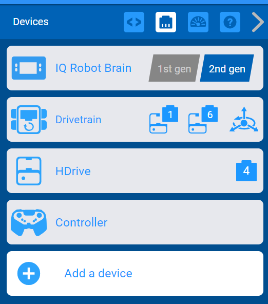

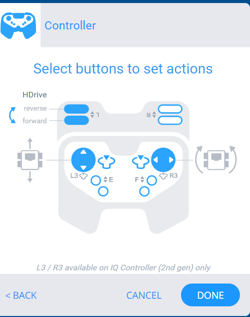

So you would program “left motor” and “right motor” instead of drivetrain? And could you still configure the controller in devices?

Yes, you would code the individual motors and not the drivetrain. The drivetrain has to be preset. For example, with the drivetrain commands, you tell the robot exactly how far to move forward:
Yes - the code I am showing uses the controller. Notice how the left and right motor’s velocity are determined by buttons A and D of the controller? Check out this article on how to do that: https://kb.vex.com/hc/en-us/articles/4407063155732-Configuring-a-Controller-in-VEXcode-IQ

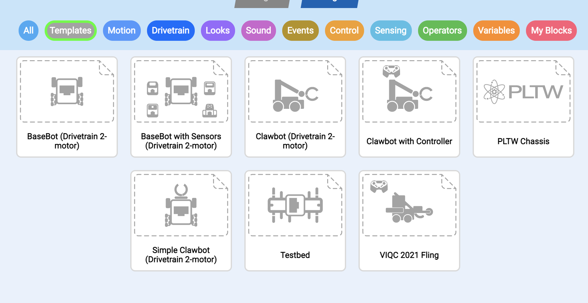

This is why we have these templates in VEXcode. These are the preconfigured drivetrains:
If you are not using one of these drivetrains, then you need to use the individual motors.

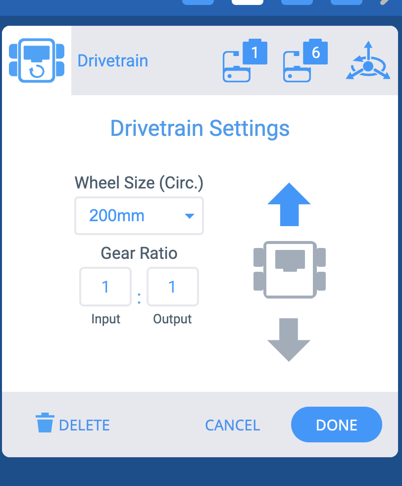

What if you want to use one of these drivetrains but change the wheels? That is why we have this setting in the robot config:
