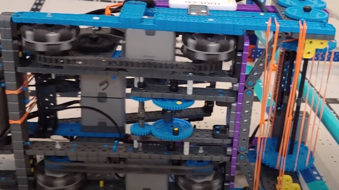

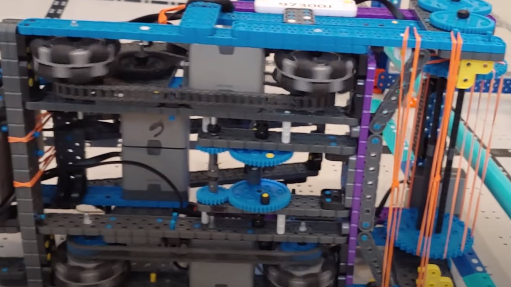

There is a pretty good look at the gear ratio Spitfire is using in the YouTube video VEX IQ 97300J Pitching In Spitfire Robot Reveal - YouTube . I would look through the comments and maybe add a comment to Joseph973 to see if they can help.

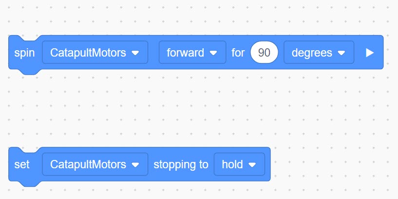

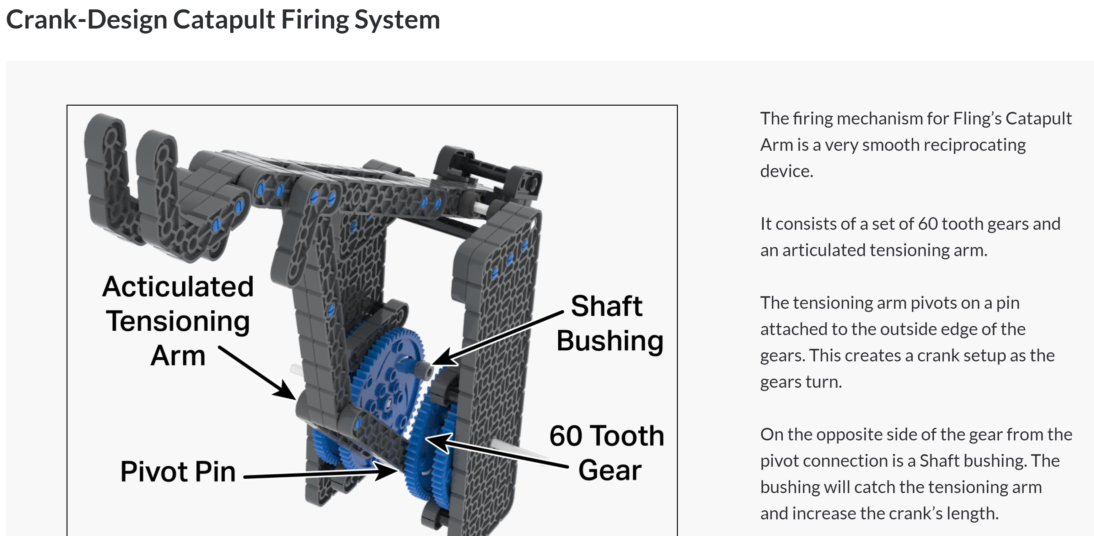

If your students are using a [spin for] or a [set stopping to hold] to hold the catapult in place, the motors will be working the whole time and may be overheating. In this case, they need a mechanical solution like Fling.
