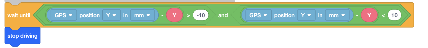

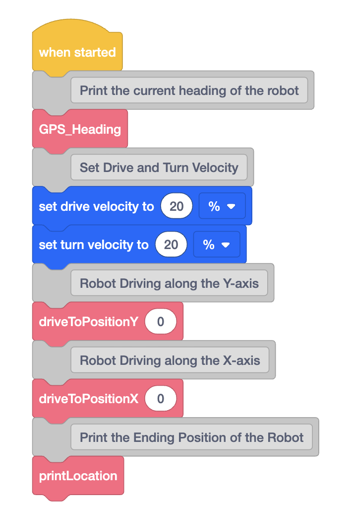

My goal is to have the robot drive to the origin (0,0) regardless of its starting position, first along the Y-axis then X-axis.
However, I came across this problem - if the drive velocity is set to 100%, the robot will just keep moving until it hits the perimeter and flies out of the field… and it works fine when the velocity is reduced to 99%…
The tolerance is set to (-10, 10) for both X and Y.
Any ideas why this happens?
