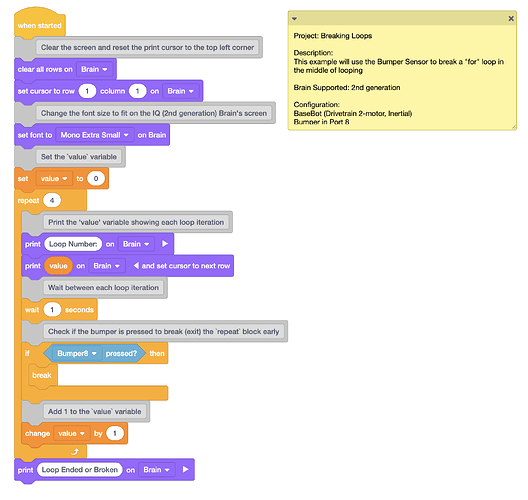

You can use the “break” block to exit a forever loop and run any code that comes after the loop

Thank you! It does help a little. I tried the Break- and looked at the samples as well. I added the breaks in with either the bumper or distance sensor. It worked sometimes. I have the bots build in the clawbot form and the optical light is turned on. I have found that turning my class lights off made it work more consistently. Isn’t that odd? Didn’t realize the sensors were that sensitive. Some still had issues getting away from the loop and completing code. I am not sure. In the sample code, with all the “print” code. Can you explain why that is used just to clarify my thoughts? Thank you for all the assistance!

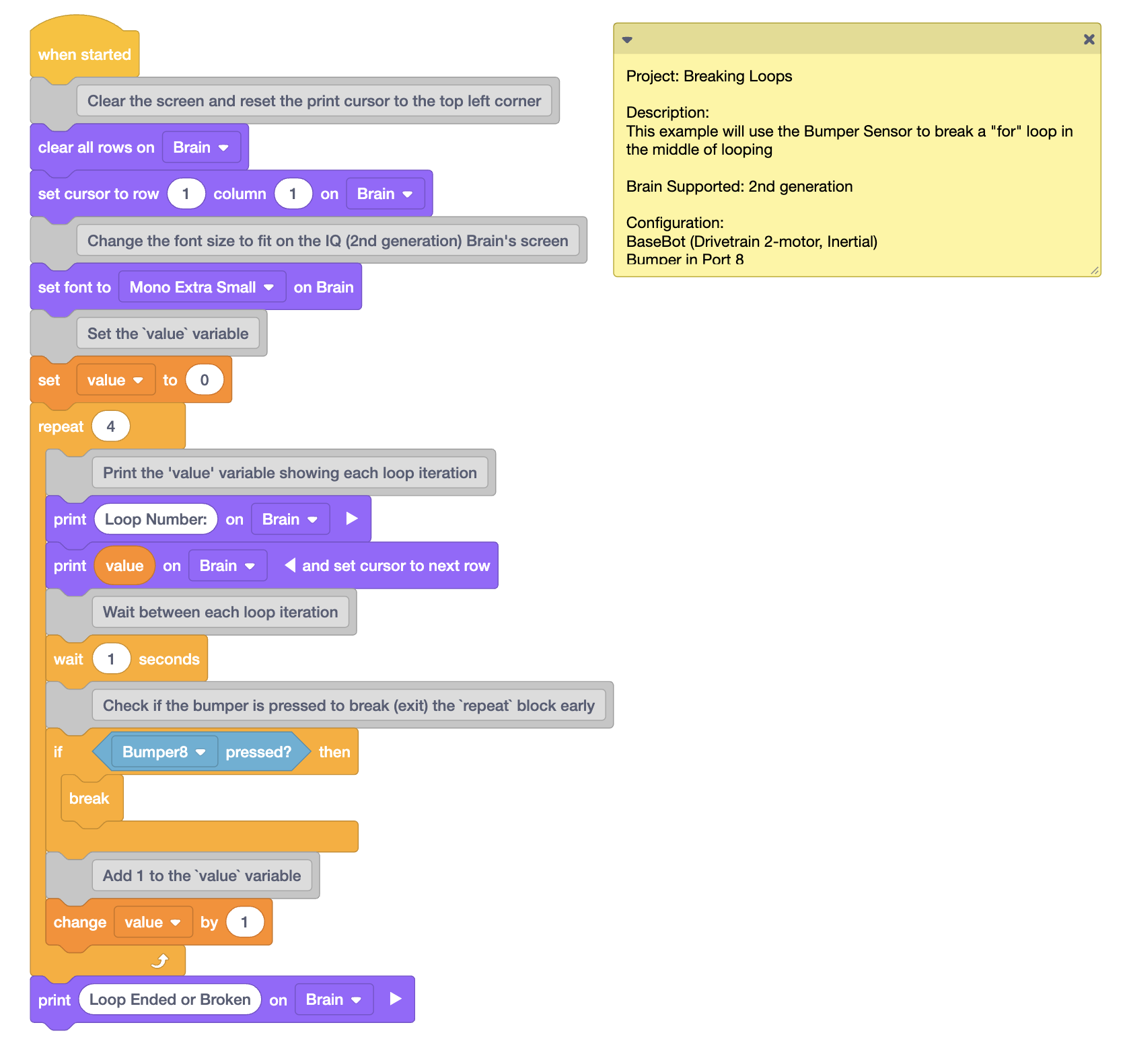

Using the [Print] blocks allow for visual feedback as the code progresses. From the “Breaking Loops” example above, the [Print] blocks are used to give a visual indication of the variable value during each iteration of the loop. This makes the product of the project flow more visible.
Using [Print] blocks is a great way to troubleshoot. You can print many things, including sensor values and text. You can also use the Sensor Dashboard to understand what the sensor is “seeing.” This is a great way to troubleshoot sensors but also to obtain the values that you will use in the code.
