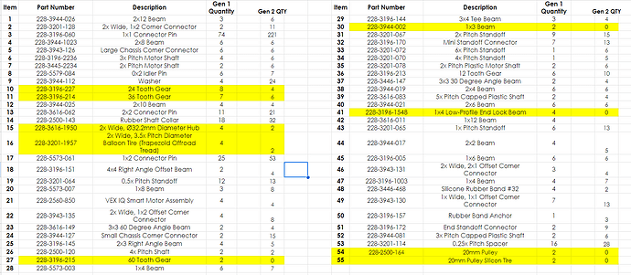

Hey all. I have gen 2 kits and the class really wants to build Ike. Is it possible with gen 2 kits without borrowing or buying parts?

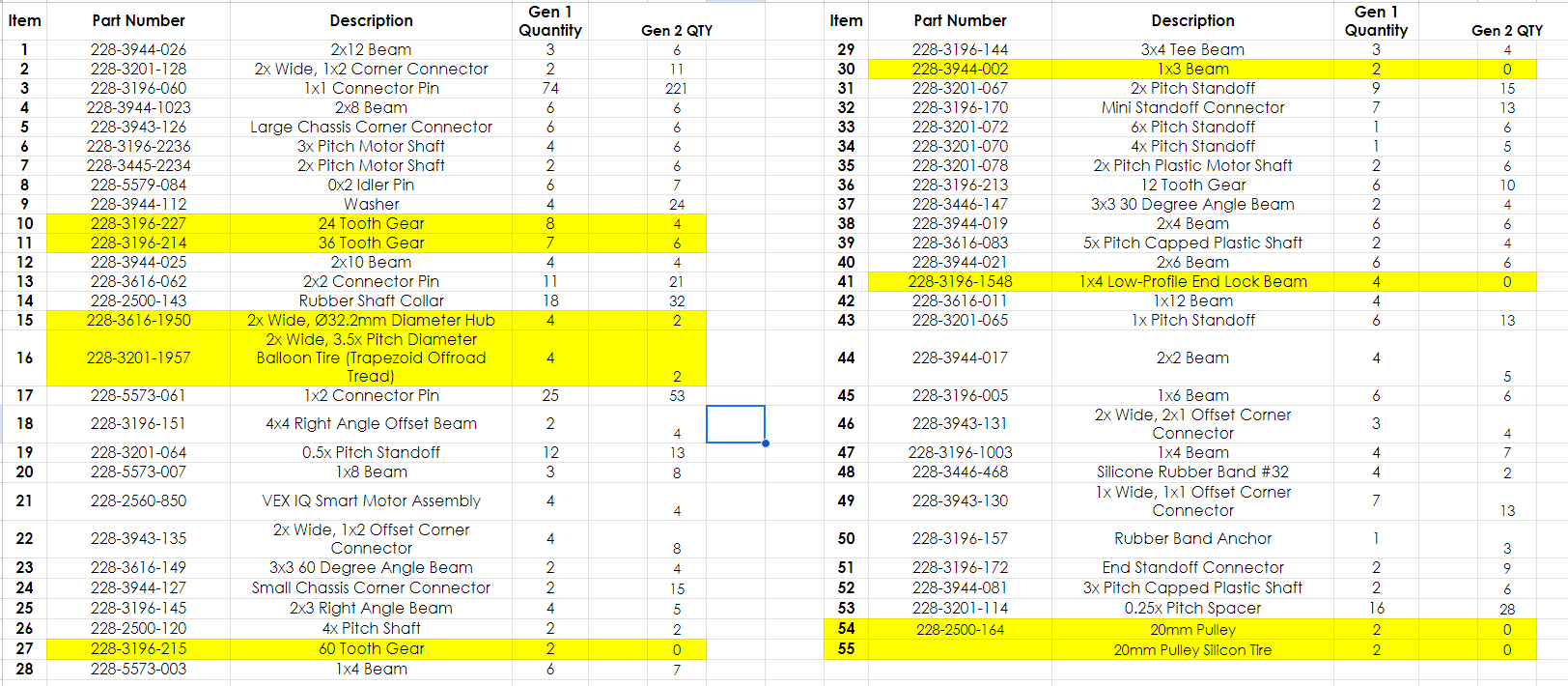

Hey @Barry_Carter_II, I have attached the part contents of Ike, containing names and quantities of each piece needed directly from the build instructions online. I have then added a column of part contents found within 1 IQ 2nd gen Education Kit, and have highlighted spots were the 2nd gen kit is lacking. While some spots the missing pieces are entirely decorative, there are some pertinent pieces not found within the 2nd gen kits, and a redesign would be needed in order to utilize one 2nd gen kit only. I’ll see if I can create something in the next few days that is possible!
