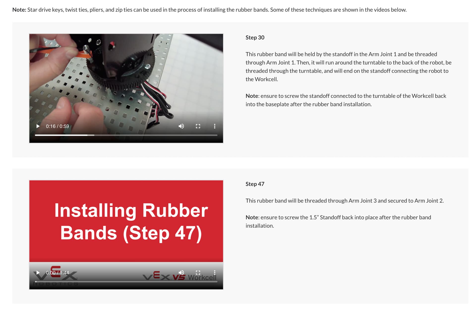

Experiencing troubles with installing the Rubber Bands on the V5 Workcell? Here is a newly published article offering video walkthroughs showing you how to install each rubber band! Let us know if there is anything else you would like to see performed.
Installing V5 Workcell Rubber Bands.
