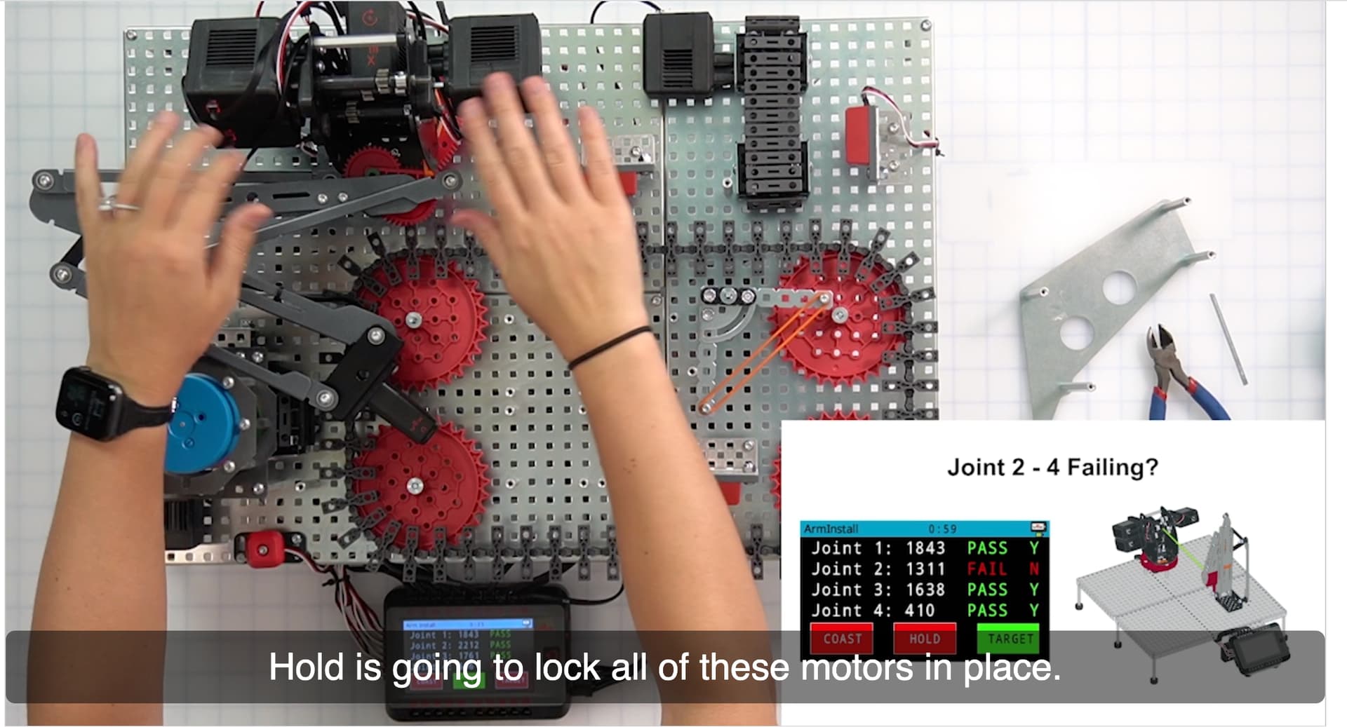

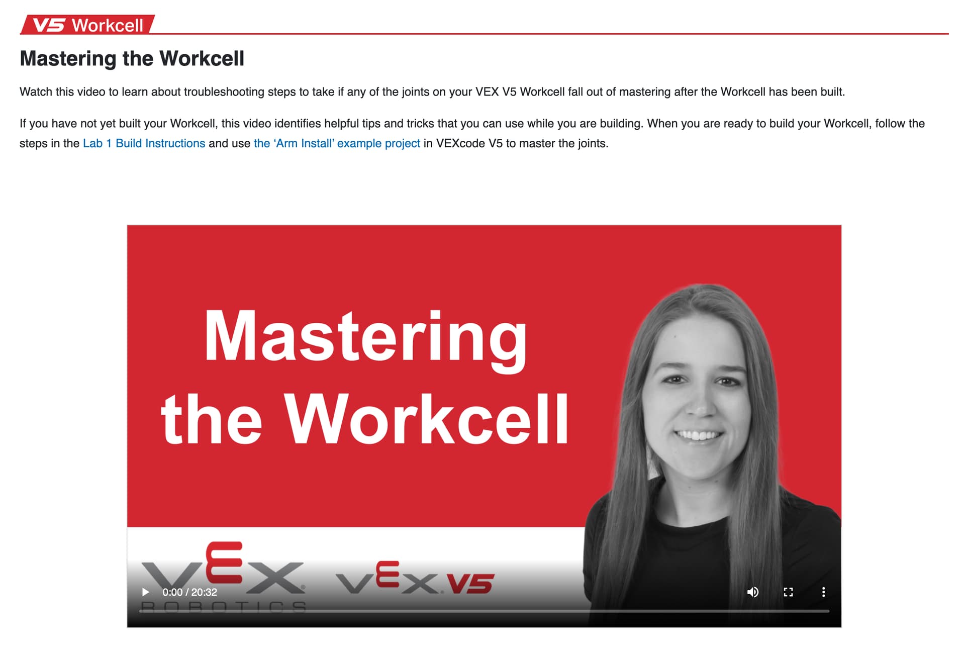

One of the questions I get most often with the V5 Workcell, is how do I re-master it? Or more specifically, how do I re-master it if it’s already fully built? A lot of people jump straight into taking the arm of the Workcell apart, but that doesn’t have to be the first item in troubleshooting.
Sometimes it’s as simple as a wire became disconnected, or a screw was not tight enough. All of those tips and tricks are covered plus more in the new Mastering the Workcell video!

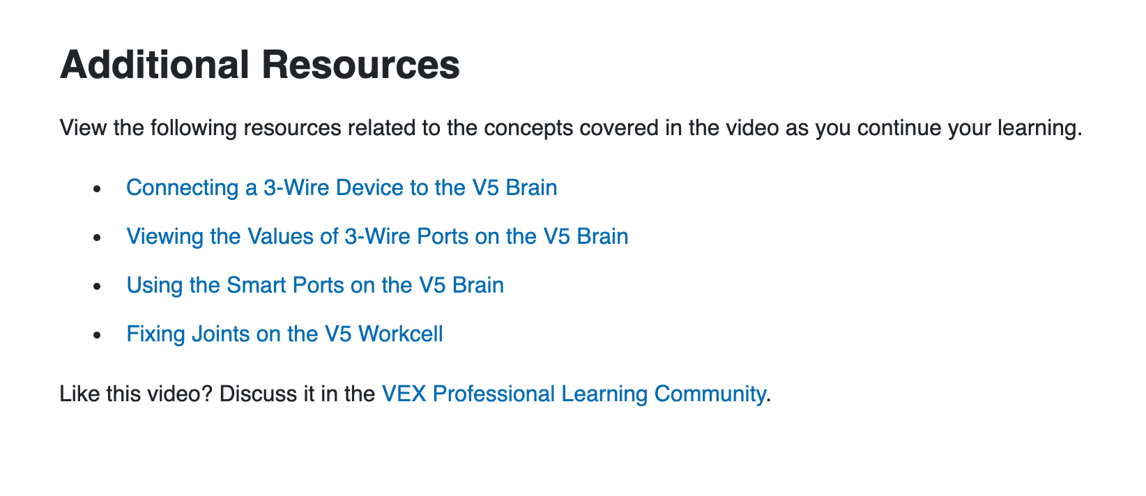

I’ve also provided some links below the video to other articles from the STEM Library that can be helpful.

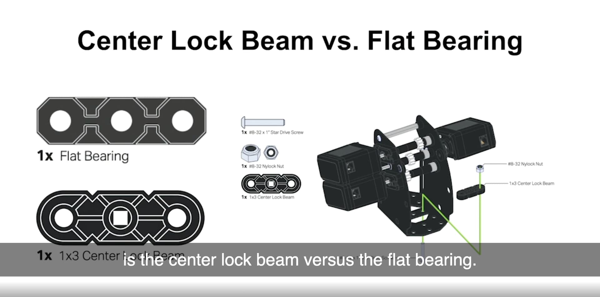

I had some issues initially during the build process. I almost fell for a few traps, finding the center lock beam! as it was in a different packet and wondered if it was a misprint initially - but kept looking and thinking.

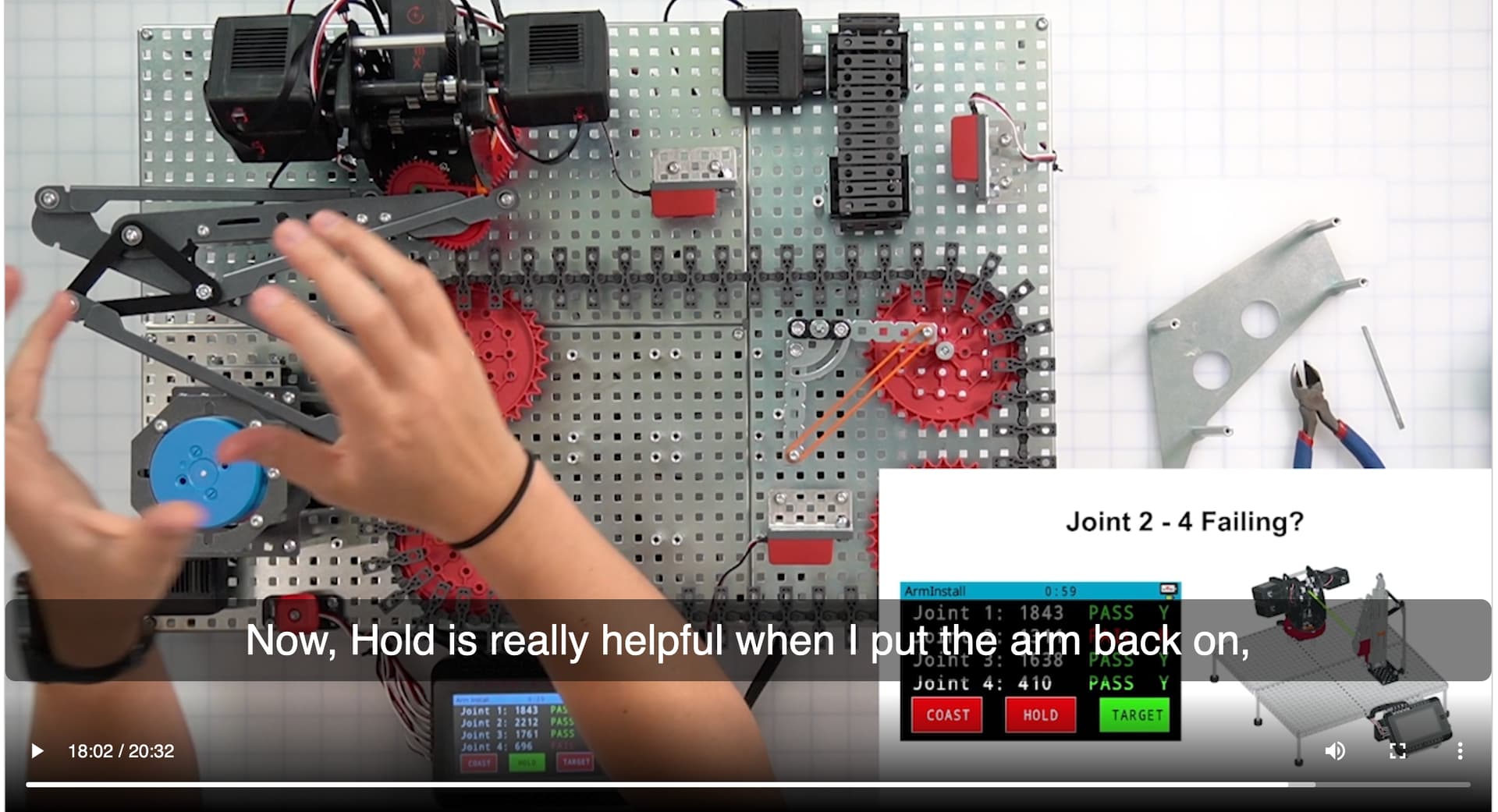

However I did make some errors when initially putting the arm on - I powered everything down and did not keep the motors on “hold” or keep the mastering jig in place! UGH! So when I got to Lab 4 - programming the movements it was way way way out.
After going back through the build instructions, knowledge bases, I figured out my error! Plus felt a little silly! A teacher who tells her students to ensure they read the instructions properly did not! Oooops.
So for anyone out there just starting the Build - these key steps are crucial - no short cuts! LOL
