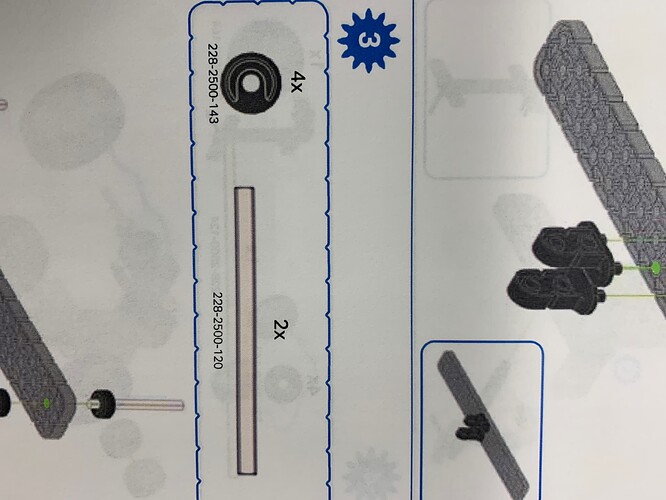

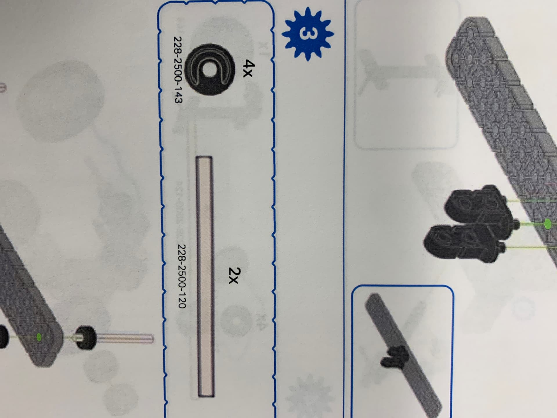

Ok. How do I tell what the part is. I’m looking for a shaft that is code 228-2500-120. I can’t find any reference for that part number.

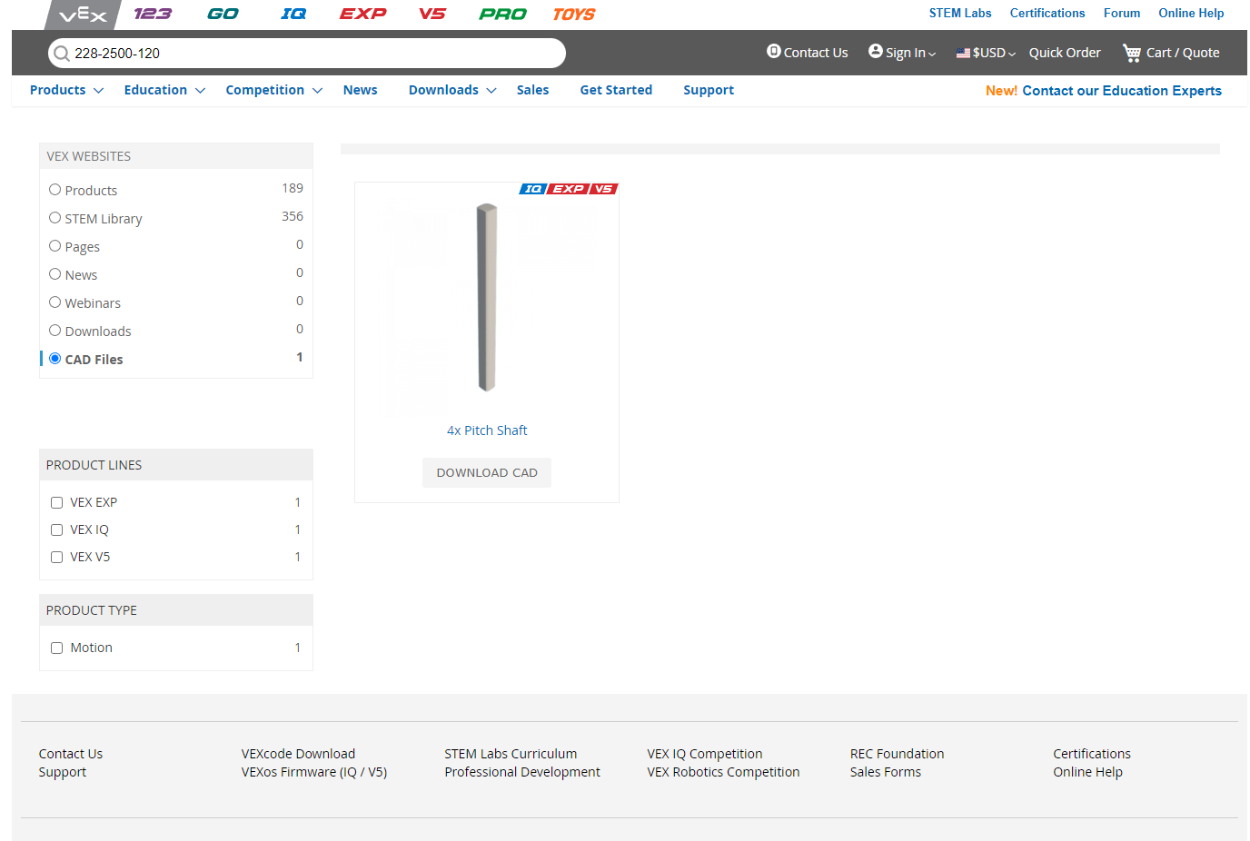

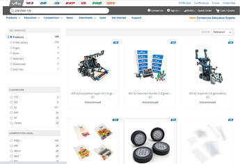

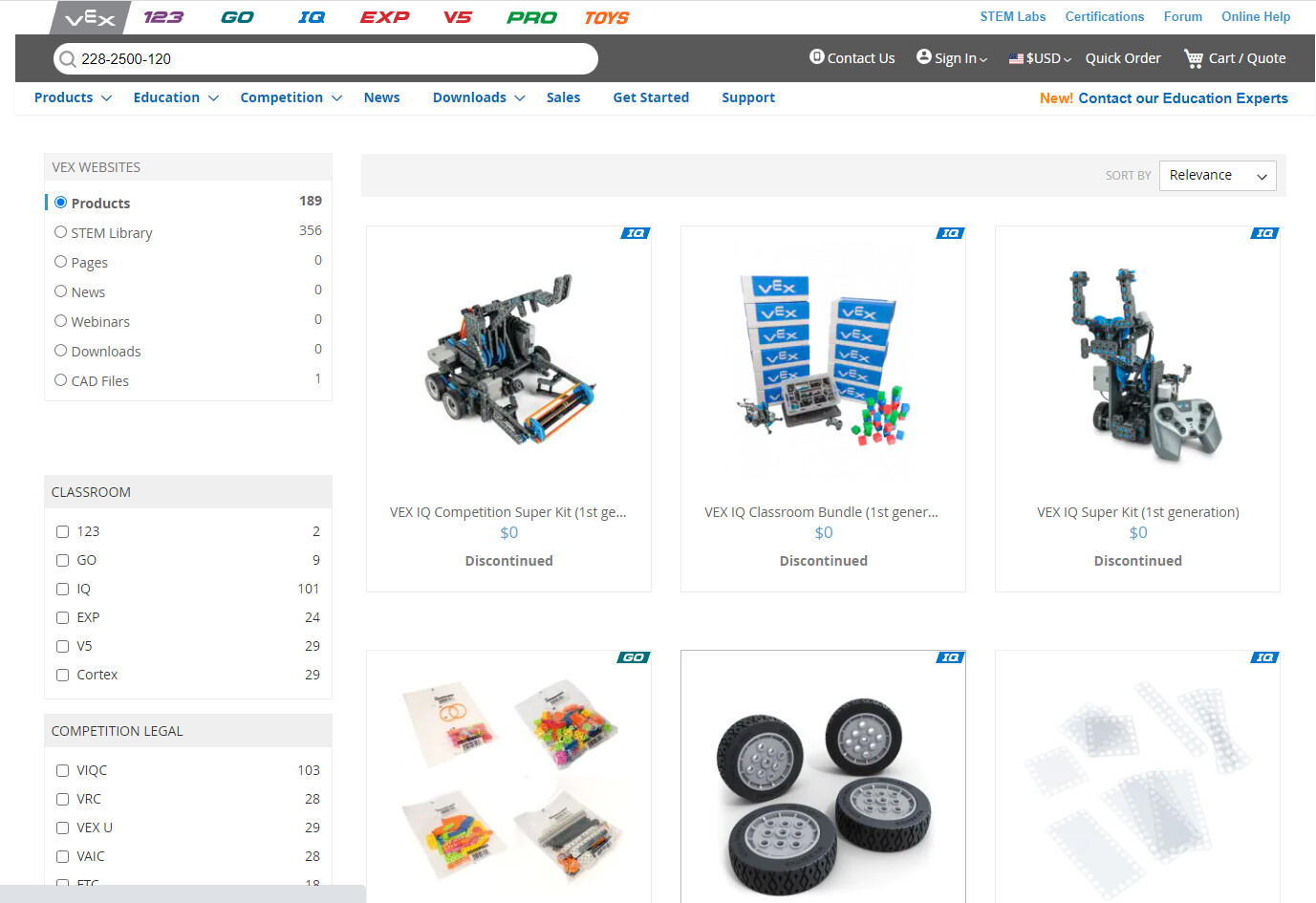

If you come across a part number you can type that part number or description of the part into the search bar at the top of your screen at vex.com for a better understanding of part information. Part Numbers are being added regularly, so all part numbers might not be there at the moment. For instance, 228-2500-120 shows a multitude of things at the moment (first picture below) but when I select “CAD Files” in the “VEX WEBSITES” category (second picture below) I can see this part is the 4x Pitch shaft
