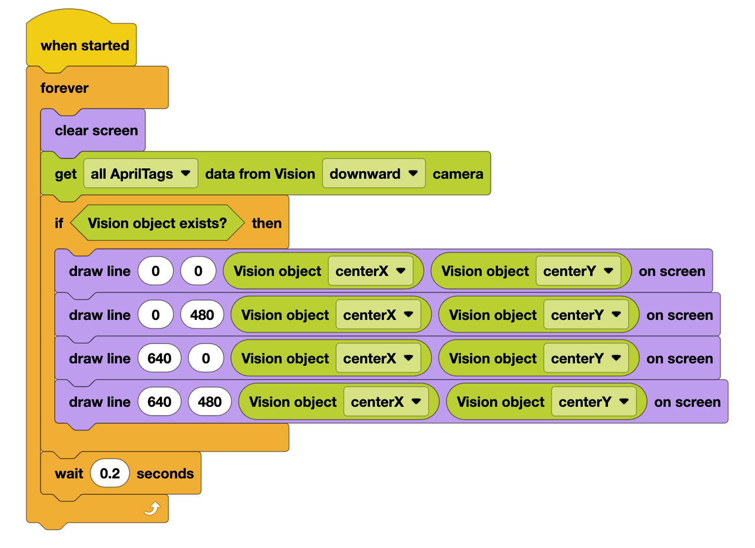

I wanted to share one of my favorite examples from the Vision blocks page. For context, the drone has two different Vision Sensors – one facing forward and one facing down. Understanding how the position of AprilTag IDs relate to the position of the sensors, especially the downward, can be tricky! This example was made to help explain and visualize the center X and center Y properties for Vision.
This is a great way to use screen drawing and Vision together and create your own tools pinpointing the center of the AprilTag ID. Also a cool way to think about how properties like center X and Y can be used in a project.
