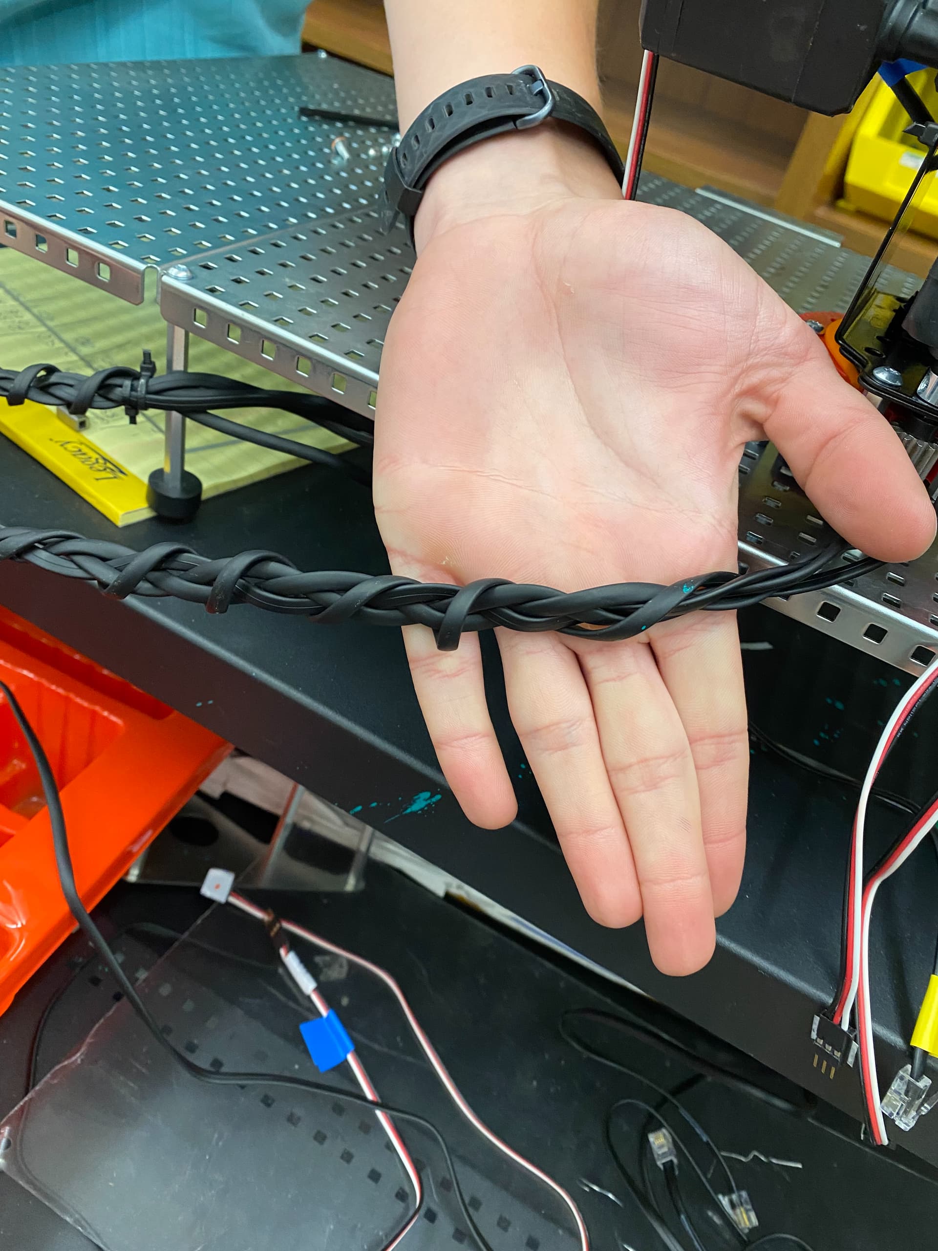

@Matthew_Goodwin I do have a specific question for you. Take a look at the picture below. My wire management specialist decided to braid the wires. He braided three of them, then wrapped a the fourth around the braid. I think he should undo the braid, keep the wires straight and zip tie them. What do you think?

@Molly_Gomes I agree with you, the wires should be kept straight and not braided as this will increase the likelihood of a wire to fail. The extreme bending of a Smart Cable (in this case braids) will cause the internals of the wire to be stretched much more than anticipated, and may cause early failure of the wire.

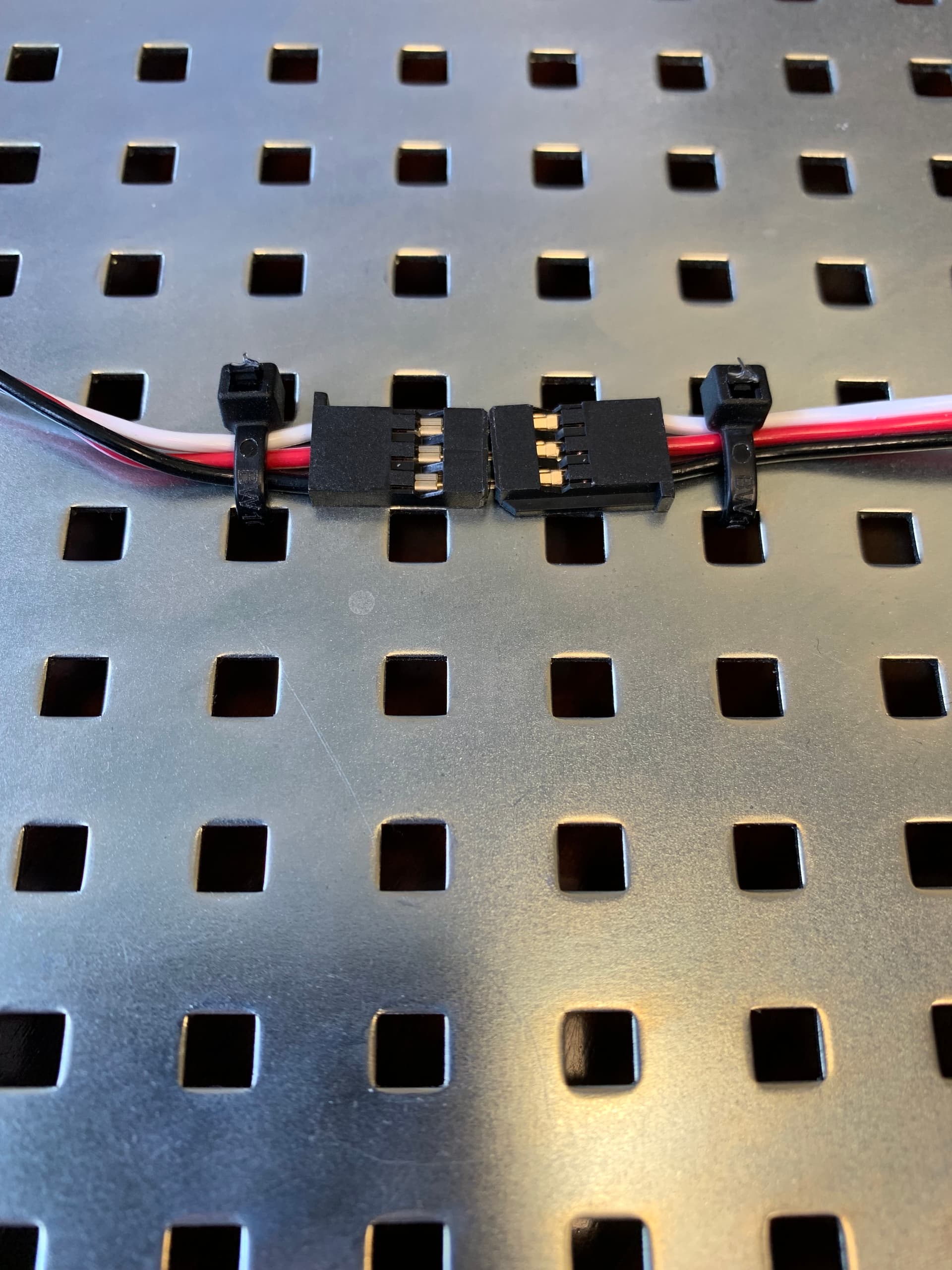

Although braiding the wires seems a clever way to keep things tidy, I’d recommend reducing the strain on the wires (like you mentioned) and simply zip tie them. There are some pretty fancy wire management tricks to explore, such as zip tying the 3-Wire extension cables in a way that the connection point is visible and secure, so keep me updated with what the specialist achieves!
