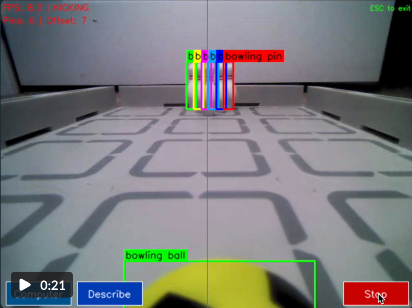

We started by introducing the AIM WebSocket Library and discussed different ways to download and run projects, including downloading through USB or Bluetooth using VEXcode AIM and running projects over Wi-Fi using WebSocket. Participants then explored how AIM can communicate with a computer, stream video from the robot’s camera, and use that data in more advanced applications.
During the workshop, participants worked through activities like programming AIM to kick the ball just like they would in VEXcode AIM, using a first-person-view video stream, and modifying prompts so an AI model, like Gemini, could help detect objects such as bowling pins. We also explored how LLMs, like Claude, can support code generation by helping improve robot behaviors, such as planning multiple bowling attempts and counting how many pins are standing or on the floor.
